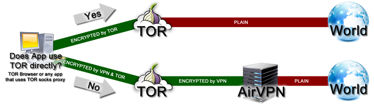

This connection mode works ONLY with AirVPN Client, because our software talks to Tor Control to detect and route correctly the guard(s) IP addresses. Otherwise an infinite connection loop occurs because communication between Tor and the guard node (the first node of each circuit) will fall back to the VPN (causing errors like Inactivity timeout, recv_socks_reply: TCP port read timeout expired: Operation now in progress, Assertion failed at misc.c:785). Warning: not compatible with Network Lock at the moment.
  • Download and launch Tor browser bundle
  • Set Tor as connection mode in AirVPN -> Preferences, press the Test button. If there is some problem, refer to the section Tor Control authentication below.
Advantages
  • Additional privacy layer: our VPN server will not see your real IP address but the IP of the Tor exit node (you can check your Tor exit IP in the Client Area)
  • Option to connect to web sites under Tor protection, even to those sites which refuse Tor connections
  • Access to Tor from all the applications transparently: no need to configure each application, one by one
  • Support to non-TCP applications which can not be supported by Tor
  • Access to AirVPN DDNS
  • Access to AirVPN DNS and micro-routing against IP address-based geo-location discriminations
  • Access to Remote Port Forwarding
  • Avoidance of any traffic discrimination from Tor exit nodes (packets are still encrypted when they pass through Tor exit node)
  • Major security layer in the event you pass through a compromised/malicious Tor exit node (packets are still encrypted when they pass through the Tor exit node)
Disadvantages:
  • Poor performance
  • Fixed Tor circuit for each OpenVPN session
  • Access to .onion sites only from browsers configured to connect directly to Tor

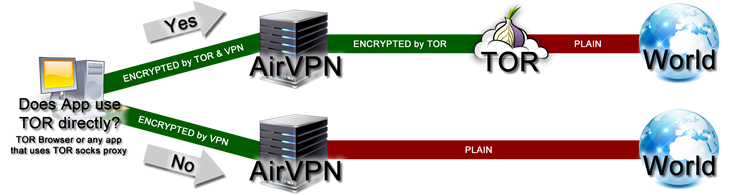

Using Tor over AirVPN
If you wish to connect over Tor over AirVPN:
  • Connect normally to an Air server, in any mode except Tor mode
  • Launch Tor after the connection to a VPN server has been established.
All the applications configured to connect over Tor will connect over Tor over AirVPN. All the applications not configured for Tor will simply connect over the VPN.
Features:
  • Our servers can see your real IP address.
  • Our servers can not see your traffic content, real origin and real destinations.
  • The Tor entry-node will not see your real IP address, it will see the exit-IP address of the Air server you're connected to.
  • Your are not protected against malicious Tor exit nodes if you send/receive unencrypted traffic to/from the final host you connect to.
Please note that, with the above setup, if you connect to our web site with a Tor configured browser, our web server will see your Tor exit node IP address, so the site will display a red bottom box, as if you were not connected to an Air server.
